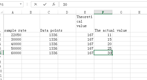

Hi all !I found a problem :I use labviewI created a digital square wave form to Export to  Oscilloscope,and remove The while loop(use finite samples) ,and Display images below,my sound card Default Sample Format:samples rate :22050;16 bits  per samples;I took the  data points in The  vi ,(vi,Classification of data points iData points n the graph below),

I don't see what your problem is.  What is that spreadsheet about?  You put the image over top of the text.

thanks for your reply!I created a square wave in labview use numbers,and This signal is then output from the sound card to the oscilloscope,my vi in 2.png and 3,png; spreadsheet ’data points is the green line marks the data point selection in 3.png  ,The other part in the spreadsheet  is the part marked in red 2.png;My reason for doing so:I chose the 1336 points , theoretically converted into 167 waveforms, we can clearly see the waveform chart display in 2.png, I will signal input to the oscilloscope , but can only display 11 waveforms , I only can change Computer sound card sampling rate to increase the number of waveform ,roughly law I made ​​an spreadsheet,
 I can not understand is the calculation I reached the limits of the sampling frequency of the oscilloscope waveform is not more than 30 , but according to the median of 16 in terms of sound , namely rate of 2 ^ 16 , so much resolution, should at least see hundreds or even thousands in the oscilloscope waveforms , but actually not the case , I do not know where the problem is , I hope you can give suggestions , thank you!
