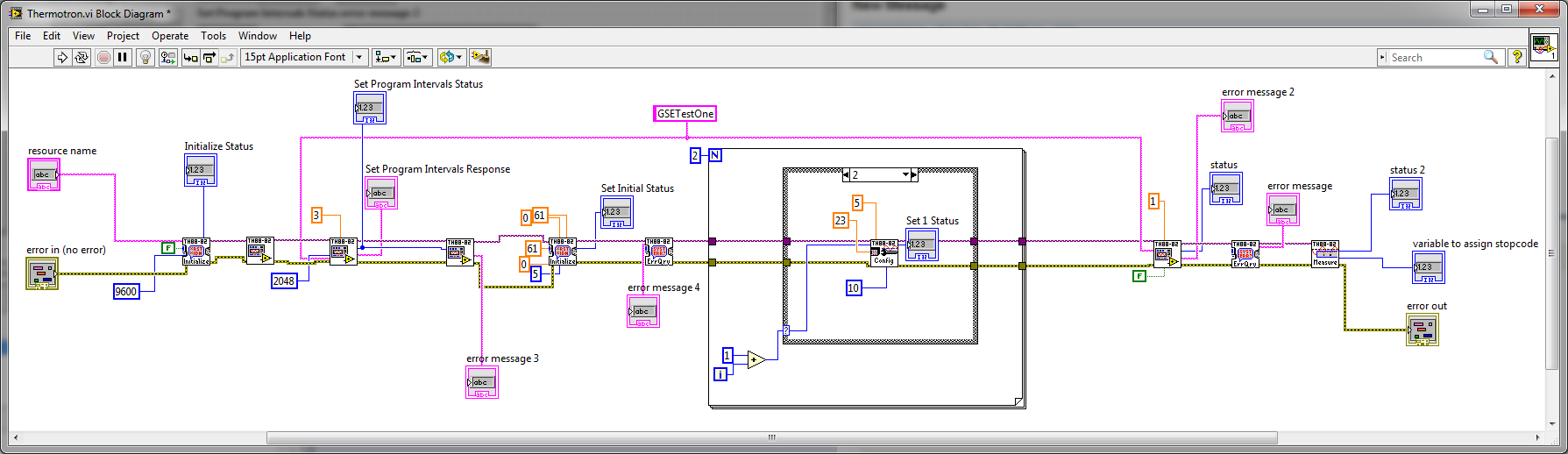

I'm attempting to control a Thermotron 8800 via the LabView drivers:
http://sine.ni.com/apps/utf8/niid_web_display.model_page?p_model_id=2778
I've had considerable luck doing all sorts of comms and control via RS232, so I know I'm communicating correctly with the device.  I've read status, turned on and off the chamber light, etc...  Now I'm trying to do a basic Test setup with a few intervals to excersize the chamber, but am not able to run a program I've made.  Below is the block diagram and front panel results:
The order of the blocks from left to right are:
  1. TH8800-8200 Initialize.vi
  2. TH8800-8200 Clear Error Info.vi
  3. TH8800-8200 Set Program/Intervals.vi
  4. TH8800-8200 Error Message.vi
  5. TH8800-8200 Set Initial Inverval Values.vi
  6. TH8800-8200 Send Last Error Code.vi
  7. TH8800-8200 Set Inverval Values.vi (called twice)
  8. TH8800-8200 Run Program Mode.vi
  9. TH8800-8200 Send Last Error Code.vi
  10. TH8800-8200 Get Stop Code.vi

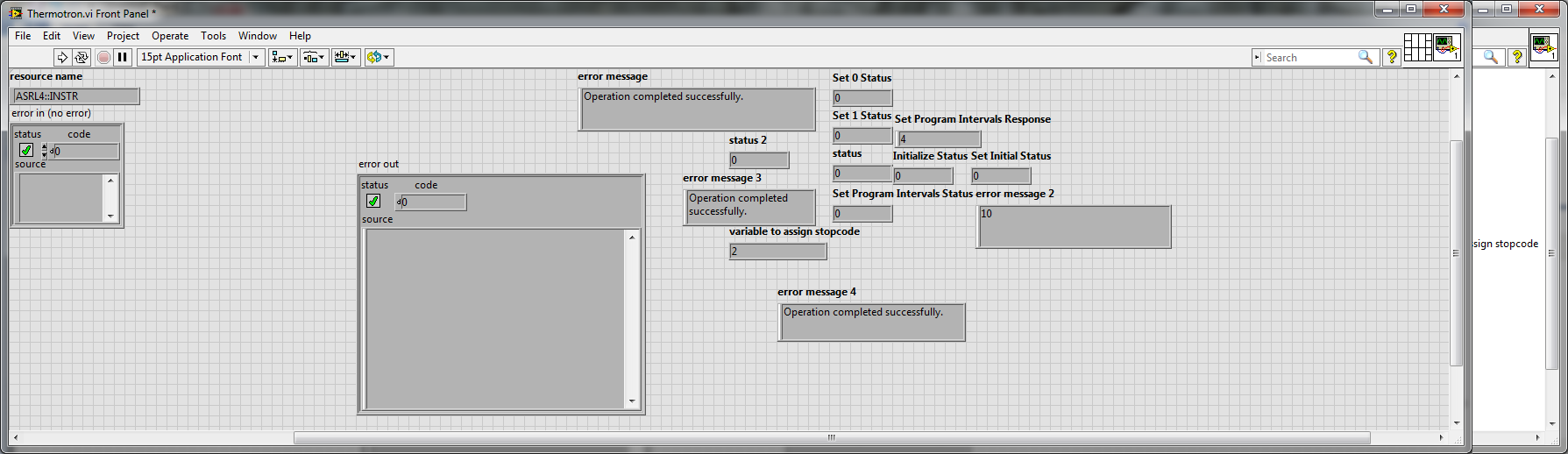

Below is a screenshot of the results/outputs on the front panel:
When I run this, there aren't any obvious errors, however, the chamber never runs, or does anything.  Anybody have any suggestions?  Thanks in advance!

Please post this vi or a code snippet png
and I will trace it and see what is wrong...

It is working now.
There was a bug in "Set Program/Intervals.vi" so I replaced it with  "Send Instruction to Instrument.vi" which is a very generic vi.
Also, the number of intervals was set to 3 and should have been 2.  The initial interval does not count as an interval.
Please see attached for a working vi...

montevan, thank you for taking time to look at this and make corrections, however, it's still not working on my system.  All of the commands are accepted without error (as did previous vi) but my Thermotron remains idle after all commands are sent.
Any other ideas?

When I run in highlight mode all of the responses from the transmitted commands are OK, so I think I have proper comms, but I guess I could be wrong.  I've turned on and off the chamber light with the TH8800 command drivers, so I know I at least have the baud, cabling, etc... wired up correctly.  I'm thinking my Thermotron will accept some, but not all, commands from the 8800 set?  The reason I'm using the 8800 set is because under the setup menu, it shows 8800 commands as a drop down option, though we've never done extensive comms like this before.
I did the changes you mentioned without success (commands seem to be accepted, but nothing happens).  Maybe I revert to the 7800 LabView drivers?
