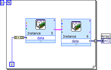

Since the USB 6008 has 8 analog inputs, I don't quite understand why you even need a mux.
I gave a solution here for a 16:1 mux. Below is a slightly different version where the first DAQ Assistant is set for Digital Port output. The second DAQ Assistant is an analog one for channel ai0, The for loop autoindexes the results so you have an array of results - each element corresponds to one channel of the mux. I also am not sure why you would need to have 000 to be a reset or no input. With most muxes, this 000 would correspond to channel 1. The way you are doing your logic with 001 being channel 1, then 111 would be channel 7 and what would be the decode for channel 8?

Thanks for the reply, that is simpler than I thought.  We need the mux because the signal on channel 1 has some pre-processing done via hardware before we can bring it into the PC, and we will have between 8 and 16 channels at any given time.  The remaining channels will be collecting the remaining (albeit dissimilar) data.  The clear is necessary to reset the mux back to channel 1 before a rescan for those signals, and yeah after I posted I realized I had not gone high enough on the logic.  I will try this out and let you know how it works.
