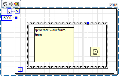

something like this comes to mind
what you need to take care of is how you want to display your waveforms,
if you want it in (6) seperate graphs, then you must have a case structure,
which is selected by the iteration counter (i) for example

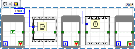

what you also could do is just to have a data-flow-connection between each while-loop, that has the "wait-miliseconds" in between, like so:

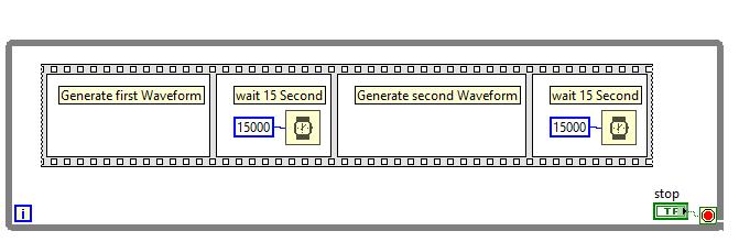

Reading your second problem description it looks like a sequence structure could do what you need.
Jwscs gave you an example already.
And if you want the waves to be generated continuously, you could use a while loop
This was my first idea, an example for 2 wave forms...
but still you can improve it..
