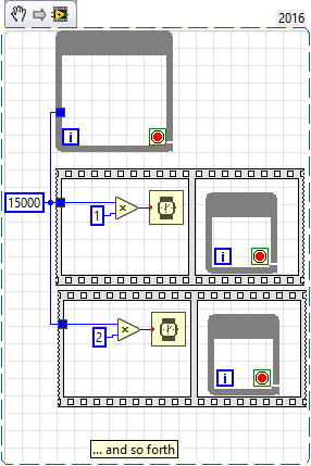

i guess we misunderstood you,
so what i now gather is, that you want to start the first loop, which will still run while the second loop starts, and so forth

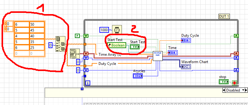

Thank You.. This logic works.
But when running multiple while loops the graph is not generating properly. It seems to have some data loss. Cold You please go through below attachment.

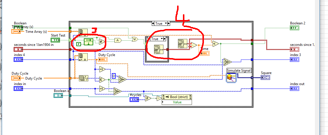

Accepted by $agar
1: if this will be the same for all loops, just declare it once and wire into the other loops from here
2: the server reference links to the same control, therefore the value will be the same
3: why do you need a feedback node here? this is a subvi, that will be called on each loop iteration, and all values should be given by the normal terminals (i am not sure what the feedback node retains -- if anything -- between loop itereations)
4: you will most times get negative values, because the get-time after the case structure will be executed most times before the one in the case structure
