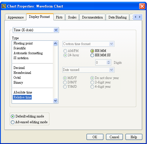

Relative time scale, you can check waveform chart properties.
Result

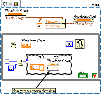

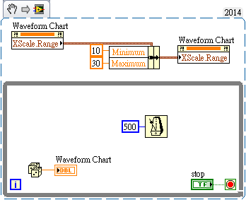

Another question about set scale to one range.
you can use property node to set.
I hope it is helpful for you.

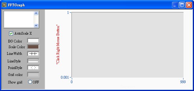

Hello Patrick, Thank you for your reply.
Check my capture. This result with your solitions.
But My X-Scale is frequency scale and its must be between 0-1000 (My sample rate 1khz), every time. I see this > 1000 now.
My X Scale setting is Relative Time HH:MM:SS for time graph. But its X-scale range everytime changing. Some times 10 second, sometimes more vs.
I cant fix this values.

Hi, YFA
Dennis is right, you can use waveform graph to solve this problem.
Waveform chart will stack your data, so your x scale range will increase.
You can clear history data of waveform chart.
Patrick

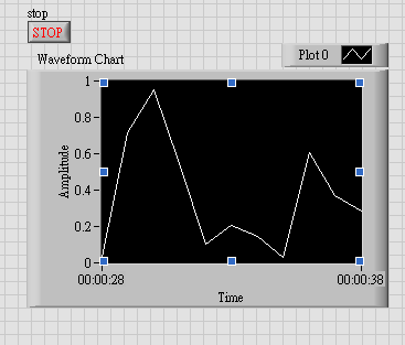

Hi,YFA
I saw your attachment but I cant find any block diagram.
If you need to store data, you can save it to excel file.
The following picture that what I saw in your project.
Patrick
Certified LabVIEW Developer
