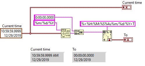

Kindly see my VI as i am having issue in time conversion.....my desired
To is
00:00:00.0000
12/29/2019
but obtaining
1:00:00.0000
12/29/2019

Your VI is a bit of a mess (e.g. why is the diagram and front panel maximized to the screen? Why is there a greedy while loop without wait burning all CPU doing nothing useful? The result never changes because the input is a constant! No loop needed.)
In any case, you are combining the time and date string without space between the parts, so you probably want to specify exactly how the parts are arranged. The following will give your desired result:

Thanks, u directed me what I was looking.Thumbs up!
