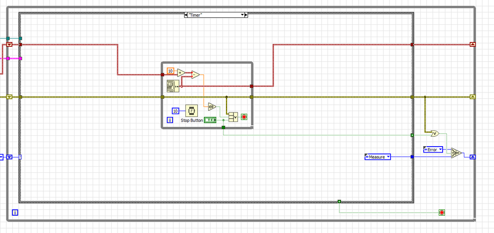

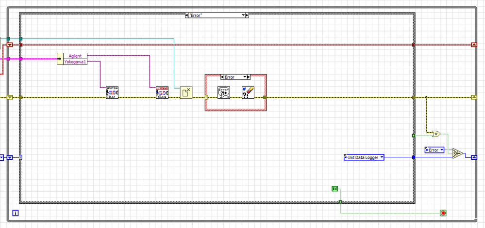

This is how I do a "wait state" in a state machine that can be aborted at anytime.
Then my Error State closes the VISA sessions and exits (it only displays the error message IF there was an actual error).
=== Engineer Ambiguously ===

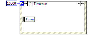

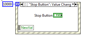

@RTSLVU
Why not use something like this?
mcduff
Message 16 of 23
(3,208 Views)
