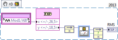

Hi, The following picture shows the configuration.
I am trying to measure RMS of a 60 HZ sinusoidal waveform with NI 9205 AI.

As I mentioned before, I would try adding another register between the IO and the RMS calculation. Looks something like this:
Also, your data-type coming off of the module is FXP<+-, 26, 5>. If you can get this down to 18-bits wide instead of 26, it should save you some multipliers since the ones on your device are 18x18. I don't know what the requirements for your measurement are, but it could solve some issues if your system can tolerate some loss in precision or range (no need to go +-16V if you're only looking at a 5V signal).

Hi T-REX$,
       Thank you for your help. Your suggestion worked. I am able to compile my code without any error.
