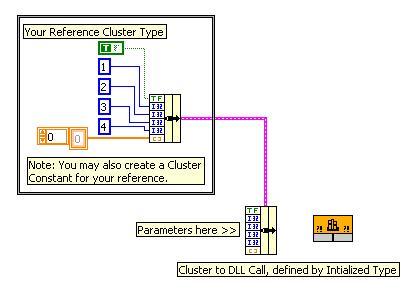

Garya505,
Can a refernece cluster not be created (See Below) to ensure that parameters are passed exactly how you specify?
Also, if you use the cluster as a control in you application. You may adjust the type def. of the by editing the control object directly. You may choose to add a Strict Type Def. control to your Labview project, that is a cluster containing the correct elements. Or, create a cluster control on your front panel, Right-Click >> Advanced >> Customize.
Please post any further questions you may have on using the cluster objects.
