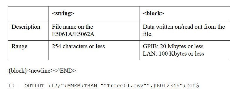

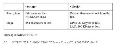

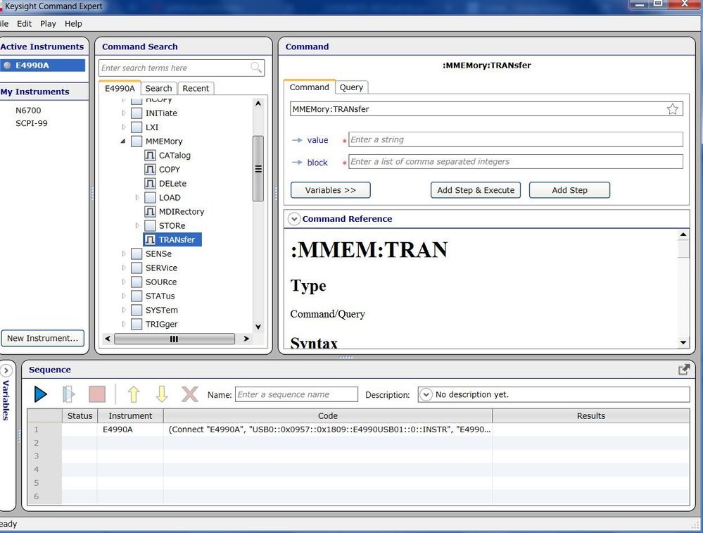

I found the command on another analyser version to do memory transfer from PC to Analyser.
:MMEMory:TRANsfer <string>,<block>
My question now is how can I convert the external PC file (e.g state.sta) as Block data transfer format in labview.
thanks for your help.

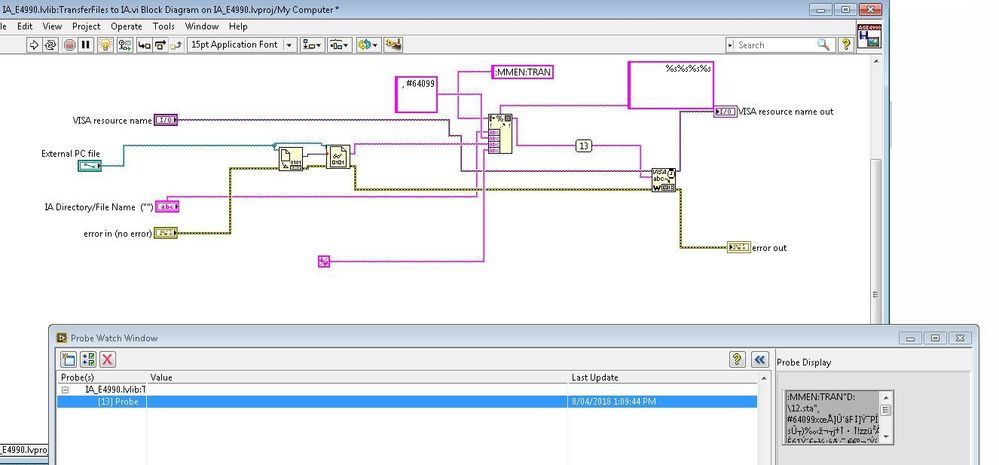

Not sure what you mean by saying that "There  is a limitation issue as labview could not write a <datablock> format". LabVIEW is NOT the issue. LabVIEW only does what you tell it to do. Your problem is that you created a command with multiple syntax errors. It's no wonder that the instrument reports back with an "Undefined header" error.
I absolutely HATE debugging "pictures", but I will give it a go. Looking at your Probe Display, I see several problems with your syntax.
1. The command is :MMEM. Notice that the mnemonic ends with an "M". It is not :MMEN
2. There needs to be a SPACE between the command and the <string> designating the filename. i.e., :MMEM:TRAN  "D:\12.sta",...
3. Why are you using "#6" in the block header? You hard coded the block data size as 4099. That has FOUR digits not six. The header should be #44099...
4. Why are you hard coding the header in the first place. Are you absolutely sure that the file size is ALWAYS 4099? It's pretty simple to write the code to create the header at runtime.
5. You appended a <CR><LF> at the end of the block. Strictly speaking, the IEEE block transfer spec does not specify a termination character at all, just an EOI. HP/Agilent/Keysight instruments appear that they do not follow the spec and needs only a <LF> termination character.
keysight format.PNG <image from Keysight Website>

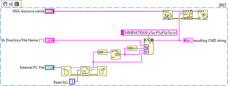

Below is how I would approach transferring the STA files from PC to instrument. Try it. You may still need to tweak the snippet. I may not have caught all the syntax errors.

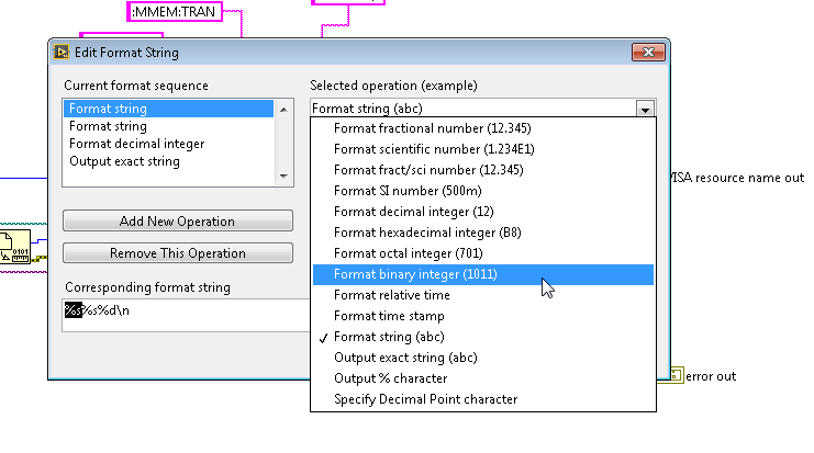

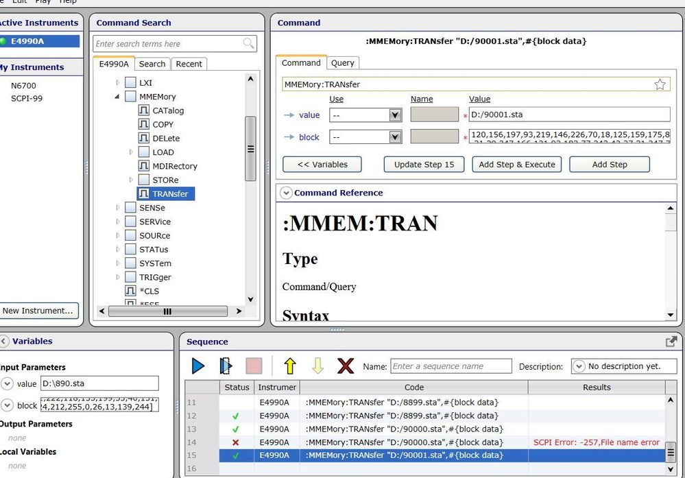

Hi Jamiva,
The limitation issue from NI arise when we are trying to duplicate the syntax from command tool expert which is passing of databytes array for the <block data>.
commaseparateinteger.JPGmemtrans.JPG2018-04-13 08_22_50-cbo-atbrftc02.cochlear.com - Remote Desktop Connection.pngfrom keysight.JPG
