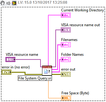

As I see, there is only a few file/directory manipulation implemented in the LV driver, this VI below. You need to implement the rest of required commands, but that should be easy using the driver VIs as a guide...

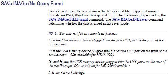

I don't think "ACTIONEVent:..." is the right command. It sets up the scope to automatically save images after an event occurs.
Use "SAVe:IMAGe" instead
I haven't used this particular Tek oscope model, but there is a way to transfer the image directly from a oscope to a PC. It's not a trivial task to program (using FileSystem:Read). I would not suggest trying it unless you are a seasoned programmer. Best bet is to use either Blokk's networking suggestions to remote into the Oscope, or use sneaker net (i.e. USB Drive).
