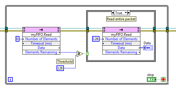

Thanks I will check out the link.  I guess i will have to convert the cluster of data to a fixed array and then send multiple Bytes at a time.  Is there any way to make this atomic, that is write the whole packet at a time and block the removal until the whole packet is in the FIFO, maybe this doesnt matter since it is a queue.

Yes, you'll have to send the elements one by one to the host through the FIFO. You can configure the FIFO datatype to be up to 64 bits long (and bit-pack half of your packet into that datatype). Or, you can keep the FIFO datatype 1 byte long and send 128 elements per packet. In this case, you could do something like this on the host:
This would prevent the host from pulling elements from the FIFO until the whole packet is received.

Thanks I think I got it working, I write 128 (could change but should not matter) bytes in one operation, then wait for a 128 bytes like you suggest + make the first 2-Byte a start byte check xFFFF (invalid in my current data scheme) and this will determine if I have a true packet, I will add a checksum byte at the end just for to be sure.  Thanks again.
