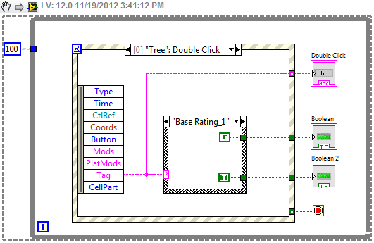

Identical functionality as an event loop shown for an additional example
