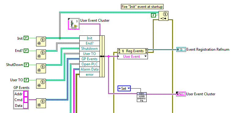

Usually what I do is to keep all User Event references in my MAIN vi. If I have multiple references, I just bundle them up using a typedef, and even better in this case you can register ALL your events using a single register node:
In the above example I also use a FGV to store the cluster holding all references, in this way I can register for all or any of the events from any subVI. But of course you can skip this part, and just use the wire through your main vi. I also atttach an example in zip, it also shows some dynamic subVI call and how you can use User Events for intercommuncation between a running subVI and the main vi.

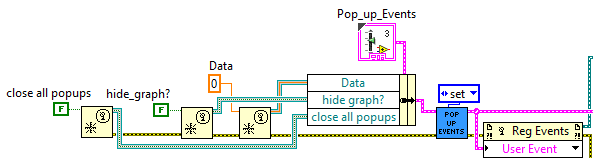

I think that Blokk and I are kindred spirits when it comes to User Events.
A couple of notes:
  1. Use data flow to ensure that you can’t do a “Get” operation on the FGV before the “Set” operation has been performed
  2. Only register for Events that you need to respond to
  3. I always build in a FGV but don't use it much since most top level vis are wired
