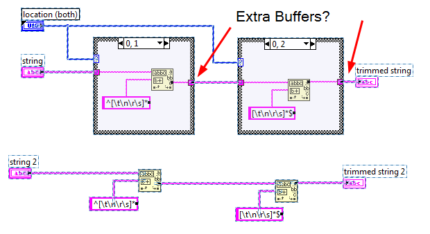

Look at the following screen shot. The case structures may add buffer copies and hence slower. Look below at see one less pair of dots when no case structures. This may be one reason why the native trim is slower.

@sth
If I use your new tester and turn debugging off for the tester, then if I place this directly in a case
it is about 100x faster than any other method, no case structures for removing from both sides and concurrent execution no problem. Try it.
mcduff
