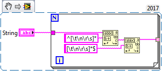

So far the best performance I get is when I inline the trim white space primitives directly into the VI, like so:

What settings are you using for your VI, I assume it is the one you posted earlier. Is it in-lined, subroutine, etc.
When I place the Match Pattern directly on a for loop, it still appears faster than other solutions posted here, not true for the Native Trim Whitespace.
