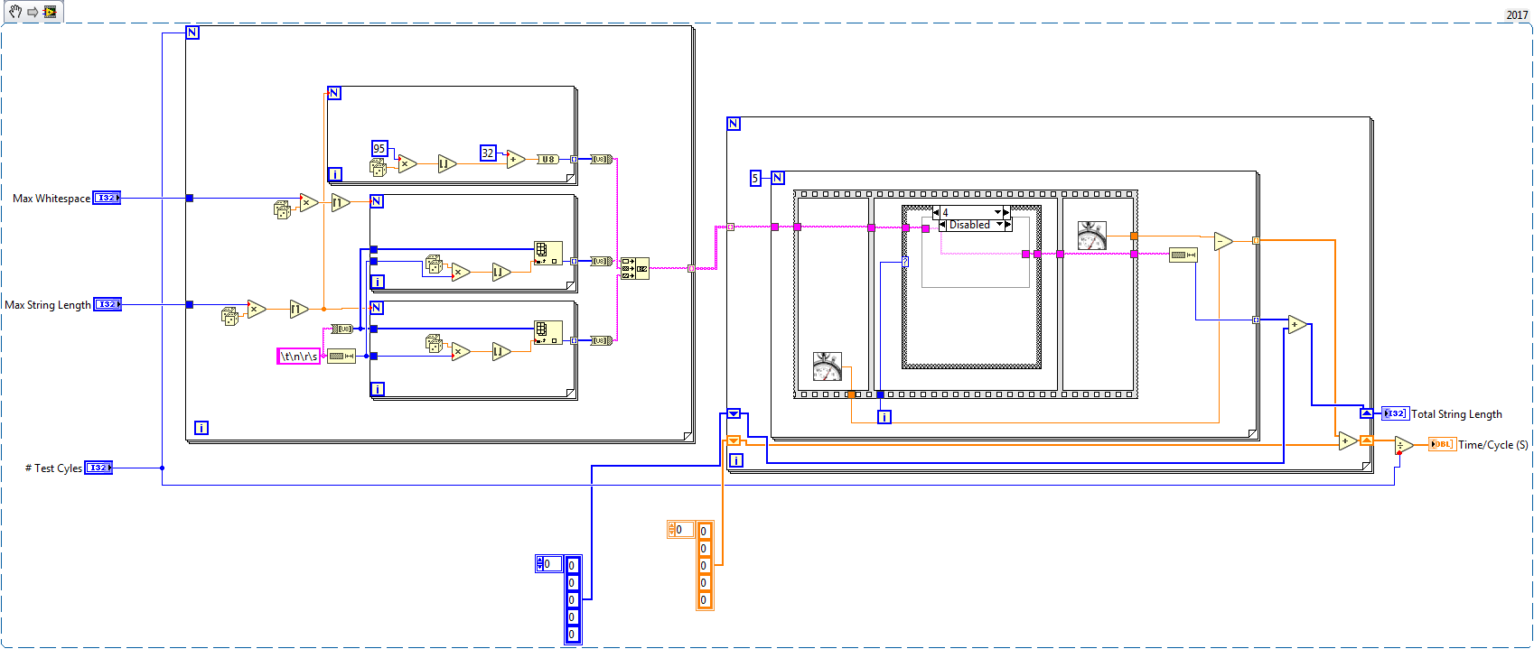

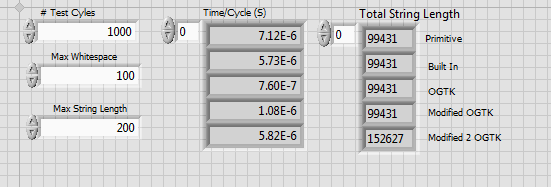

Updated the bench mark. Made the following changes:
  1. Moved String Creation outside loop, all different methods operate on the same string.
  2. Found the total length of all of the strings with the white space removed, since the compiler needs to return the length, it cannot skip code.
  3. Turned debugging off.
  4. Something weird is happening with Modified 2 OGTK, it sometimes is getting stuck and it is returning a different string length than the other methods.
  5. OGTK seems like the fastest on my computer.
  6. The times are somewhat dependent on the case structure order, ie, first few cases seem slower. If I rearrange they become faster.
