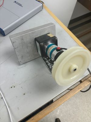

Hello NIquist, thank you so much for your feed back and from my understanding I am using a DAQ by national Instruments, that I found in the lab I am currently at. I will send photos, and I hope it will help. Please let me know if it doesn't I can also try to figure it out further with the person who may have purchased it.

and its connected to a Electro-Craft Max-100 115V PWM SERVO DRIVE P/N 9078-0121 B

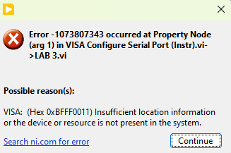

I also ran into the issue of an error that mentions:

This message is saying that you are trying to do something with a serial port but you didn't give it a usable serial port reference.  It could be that you only have COM1 and COM2 on your PC and you are telling it to initialize COM3, or it could be that you're passing it a blank reference or some other unusable string that isn't a COM or ASRL reference at all.

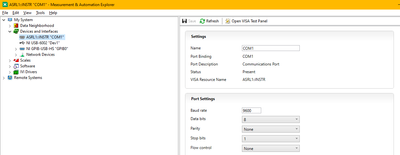

Kyle97330 is correct.  I can run your code fine with my USB DAQ, but I don't have an Arduino connected or your hardware, so I only see the motor speed voltage change.
If I change my COM port from COM1 (which I have), to COM2 (which I don't have), I get the exact same error you posted.
Are you using a USB to Serial converter perhaps?  Maybe you need to install drivers?
You can check your COM ports with NI-MAX under Devices and Interfaces.  Make sure it's working before you run your VI...

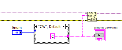

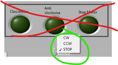

A little hint.  When you want to select options like CW, CCW, STOP, etc. that should only run one at a time, use an ENUM control with a case structure.  This code does the same thing as all your buttons and local variables 😝 and you can't choose two commands at once.  You can also use the radio button control if you prefer buttons.
