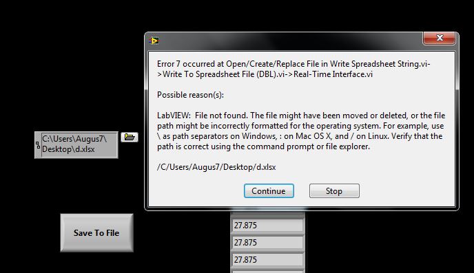

Hi August,
from your picture it seems you're trying to save a file on your PCs harddisc while running a VI on a realtime target (conclusion from error message mentioning "Real Time Interface" and different path formatting).
You can't save a file from your target to a different PCs harddisc!!! You have to create that file on a local storage (using proper file paths) or use network access to transport data (like shared variables) to your PC...

Hi august,
to repeat my message: You can't save a file from your target to a different PCs harddisc!!!
Your VI runs on the target, even when you watch it running on your monitor. Just look at the left down corner of the VI's frontpanel:
Here LabVIEW tells you where the VI is running. In the shown picture the VI belongs to a project and is running on a target named "Demo-Fzg" (which is a cRIO)...

Hi august,
to repeat my message: You have to create that file on a local storage (using proper file paths) or use network access to transport data (like shared variables) to your PC...
LabVIEW comes with a lot of examples. Did you check them?
LabVIEW comes with some predefined projects. Some include host ("PC") and target ("RT cRIO") applications like yours. Did you check them?
You always have the option to transfer data from target to host. Use them to automatically create files on your host's harddisc!
