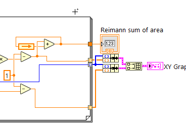

Modify decaying Gaussian like below.
  1. Make your points index on the for loop.
  2. Then bundle the arrays (x, y array)
  3. Then put the clusters into an array.
mcduff

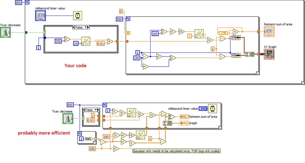

Your x-values are equally spaced (x0=0, dx=1), so a simple waveform graph is sufficient.
Also:
  • There is a primitive for e^x and 10^x,
  • The /250 exist is both case and thus belongs before the case structure. In fact, arranged right, the two cases only differ by two diagram constants and can be pulled out of the loops.
  • I am sure there is a way to have fewer coercion dots.
(3,717 Views)
Also note that you are doing a lot of duplicate operations. For example the Gaussian only needs to be calculated once before the loop and not 500 times in a row. The outer FOR loop only applies scaling.
There are plenty of ways to rewrite that code more efficiently, here is one possibility.
