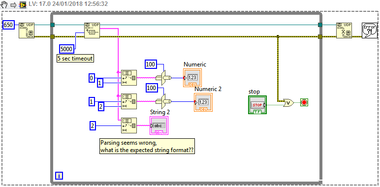

Edit: here is your modified VI. You should also program error handling, so if you need, you can clear Timeout error for example...

@Skigorv wrote:
Thank you very much for your response!
In the string format I wanted to see the timestamp because the Raspberry Pi also provides that (forgot to mention that in the first post)
Thank you again, I will make these changes as you suggested.
Still, this is definitely the wrong way to parse an incoming string using LabVIEW. If you show your typical string format, we can suggest a more straightforward parsing...
