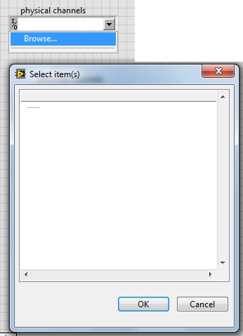

To recreate this, I made a stupidly simple test VI that just has a Physical Channels I/O control:
Using the VI, it works as intended.  (I didn't have the module plugged in during this picture, so the list is intentionally blank.  This is expected output.)

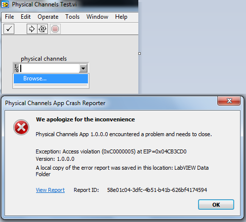

Then I simply create a Build Specification and create an EXE out of this VI.  (NOTE:  Both the VI and the EXE are being run on the same computer that has LabVIEW 2013 and the ULx library installed.)
When I run this .exe, it opens fine.  But whenever I click "browse", the program crashes instead of opening that window:
Whenever I click "View Report", this is all I see:

Anyone have any suggestions as to what I am doing wrong?  I do not do any modification during the Build Specification.  I just set my VI to be the startup VI.  Perhaps I am missing a library?
