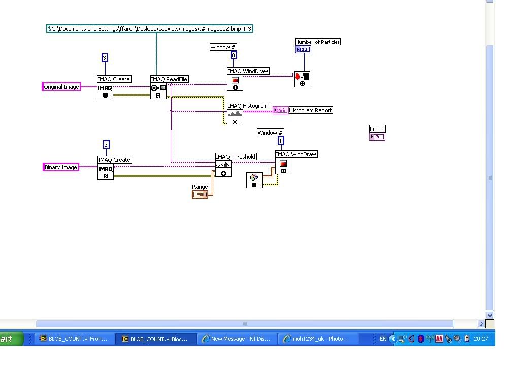

hello i want to create a small VI that can count number of particles from a image that i load up. please see the attached image of particles and the VI printshot.
I have used the tutorial "counting number of particles" but still the above VI does not work. it shows the number of particles = 1.. I do not know why it is doing so??
I am not an expert in Labview so please can someone tell me where the problem is. sorry i could not attach the VI file itself but i have given an image of it..

p.s. in the above VI i read the image from file and count the number of particles. i do not do it to the binary image becuase the binary image is only a black screen
when i run it

Hi Farhan,
I would suggest you to try the VBAI or the Vision Assistant to fine tune the Image processing Module.
this would give you good idea of the step by step processing after applying filters.
Then you could export the same algorithm to LabVIEW and use it there.
Sundar.

Thankyou everybody and Sundar N for your help. The VBAI was very helpful and did exactly what i wanted - to count particles from
an image. it now works. now i am working with the camera to count particles rather then reading the image from a file.
