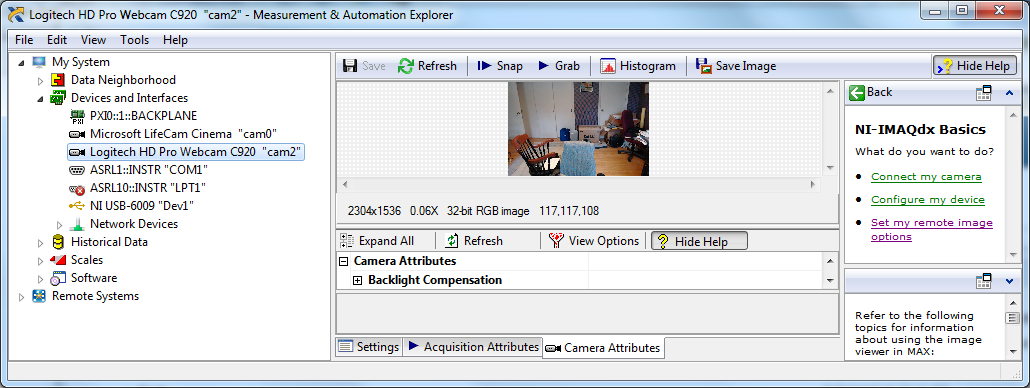

You say that MAX "sees" your USB Camera.  Can you do a Snap or a Grab of images in that camera with MAX?  Here's an example of a Snap on my PC -- I've chosen one of the three cameras (there's a Network Camera not showing, under Network Devices, also) and clicked "Snap".  I assume you have the Vision Toolkit and the IMAQdx Drivers installed ...

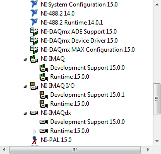

Can you show us a MAX Screen Shot, similar to the one I posted, that shows your Camera in the Devices and Interfaces pane, preferably after you click on the entry to select it?  You might also show a screen shot of (part of) MAX's Software tab, particularly the expanded entries under NI-IMAQ, NI-IMAQdx, and NI-IMAQ I/O.  Note that this will probably also answer Dennis' question.  I've included an example from my system.

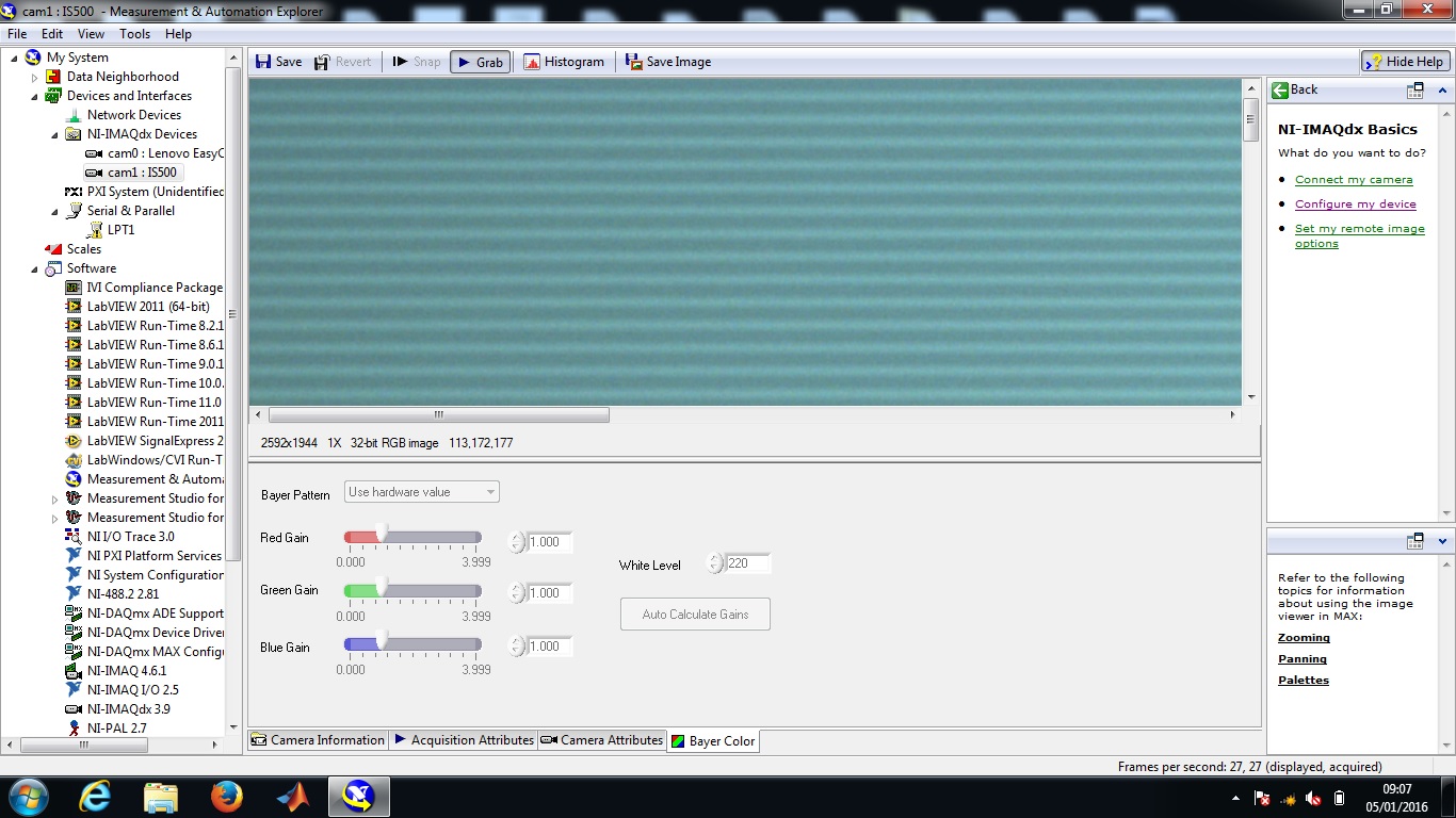

I attached MAX screen shot.
you can see the camera model IS500 on the left (cam1) and the picture when pointed on the computer screen.
This is a microscope camera with no imaging lens so you can't get an image but it is defenetly alive and responsive when I point it to different directions.

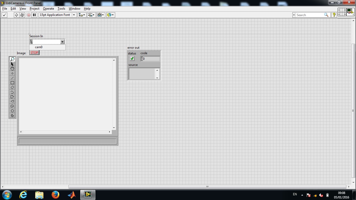

I also attached screen shot of the LabView code and front panel. The code is the same as in my original post link and it works but only with my laptop camera (cam0).
from some unknown reason I don't have the option to choose the USB camera.

Please, (note, I did say "Please") do not attach pictures of your code.  We cannot "test" images (unless they are LabVIEW Snippets, which yours were not), we cannot "look at other cases of your Case Statement" or test the wiring, and (most important) we cannot run your code to see "what makes it tick".  Instead, attach code, meaning the VI itself, or if there are a lot of them (inside a Project, for example), compress the Folder holding the VIs and attach the resulting Zip file.
The Observation is that you seem to be running 64-bit LabVIEW 2011.  I recall that "not everything works in LabVIEW 64-bit" -- most of us run LabVIEW 32-bit on 64-bit Windows.  In particular, I have multiple USB and Ethernet cameras connected to my PC, and am able to record from them (both Snaps and Grabs) using IMAQdx.
The image on your most recent Post looks like it may be the result of a Grab in MAX with your IS500 camera.  Is that correct?  If so, then it looks like the Hardware is working and you have a Software problem -- getting your actual code may help us find a "fix".
