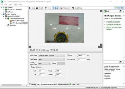

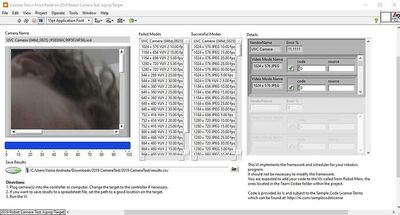

Using the camera test VI and NI MAX it is possible to obtain images in both cases.

Here’s a screenshot of our Vision Processing. We tried using a standard program and recreating the roborio image, but that didn’t work either

We've already tested that, and even with theIMAX closed unfortunately we don't get camera response
