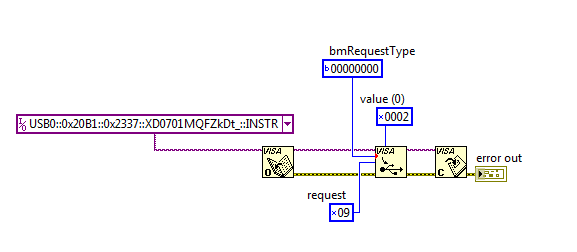

I have a development board where I am developing firmware for a USBTMC device. This device will contain 2 configuration descriptors. In Labview, I issue a Control Out transfer to set the configuration to use per USB specification. Here is the code:
The bmRequestType's bit-map field corresponds to a Host-to-Device (0), Standard (00), Device (00000) request type. The request, 0x09, corresponds to SET_CONFIGURATION and value is the configuration descriptor number I wish to set.

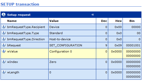

When I run this code and observe on my ellisys USB analyzer, I see that the configuration value being set is 0 instead of 2. See below:
The highlighted area of the table shows what was actually sent over the bus to my device. This is problematic for 2 reasons. One, the code is not setting the desired configuration as expected. Two, instead of setting to the default configuration (1), VISA is setting the configuration to 0 which translates as "not configured".

As far as I can tell, number 3 indicates that "VISA USB Control Out" thinks it is passing config value number 2. However, I can continue to see that a value of 0 is actually being sent over the bus with my USB analyzer.

I did have Agilent VISA drivers installed too. I uninstalled all VISA implementations from my computer including NI VISA. I then installed the latest NI VISA (v15.5) and re-tried my test. I saw the same results where the configuration value for SET_CONFIGURATION is being set to 0 no matter what I actually set it to in my VI. Other commands appear to work. Using the same "control out" primitive in the VISA palette for USB I can send SET_FEATURE to set RemoteWakeup on the device (bRequest = 3, wValue = 1) and my USB analyzer shows me that command is making it to the device as-is. I can also use the "control in" primitive to read the configuration descriptor and that works OK too. One other command that had unexpected results was SET_ADDRESS. I tried to set the address to 0 and my analyzer showed me that the command had bmRequestType modified to be a vendor request instead of a standard request. I suppose this is a safety measure as you would never want to change the address of your USB device in LabVIEW code, that is the responsibility of the USB hub.
I tried the same SET_CONFIGURATION example on a clean Windows 7 x64 virtual machine with LabVIEW 2014 x64 and NI VISA 15.5 installed. I saw the same results.
I then tried the same example on a MacBook with OS X Yosemite, LabVIEW 2014 and NI VISA 14.0 and it appears to work! My USB analyzer shows me that the configuration descriptor value I wish to set is what I actually set in the VI.
So it looks like this is a Windows problem? Can you give me any more insight on this?
