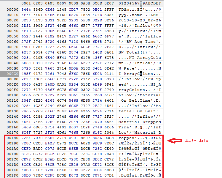

The attached file is corrupted. Only a few TDMS meta data are written into file. And the rest data of the file are all dirty data. It looks like that some pieces of raw memories are dumped into the file.
You can zip and attach your original file here, I will try to recover the data as many as possible for you from the original file. But I'm afraid that the original file should also contain only a few meaningful data but lots of dirty data.  Is there any power outage or crash happened during logging data?
