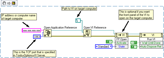

Hi KowdTek,
Are you doing something like this?

Hi Dr. Horrible.
Yes, it's very similar to your example. It's working now but not both ways and for some reason I can only "ping" my PC one way.
Can I just launch any VI created from the main PC or it has to be in the library? I asking because I tried launching a VI (simple VI) and it did not pop up to the remote PC.
