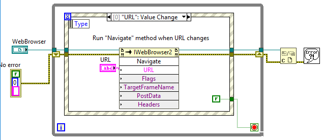

I'm trying to create a VI where you have a web page opened inside a Lab view program. This web page should only be connected to a certain IP address corresponding to an electric meter. I have tried putting the IP address inside the URL, but each time I try to, I am either unable to connect or I get this error :

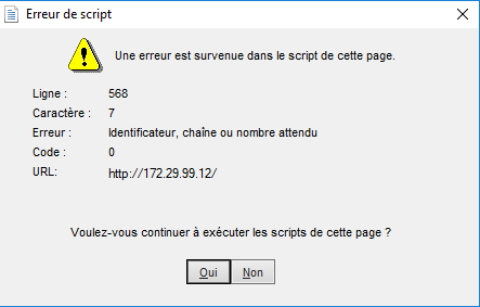

 A translation gives : "An erreur has occurred in the script on this page", the Error being : "String, number, identifier expected". It then asks if if I still want to execute the scripts on this page. If I say yes, the page is then stuck with a black screen, and loading is written in white in the middle.
Both Edge and Firefox (the two browsers installed on the computer) correctly link to the IP address without any issues. I tried changing "/" to "%2F", its UTF-8 equivalent but it didn't change anything. Here is a copy of the program :

please try to open the URL with Internet Explorer (WIN+R  and enter "iexplore" without the ")
i assume that the library you are using (possibly this one https://forums.ni.com/t5/Example-Programs/Simple-LabVIEW-Web-Browser/ta-p/3501835) is utilizing the internet explorer via activex.
it might be, that internet explorer has problems with whatever script is embedded in the website.
EDIT: or it is an activex problem
unfortunately i suppose, this would be problematic to troubleshoot without having your device at hand.

Alright so turns out you were right : I should have tried using IE and not Edge and Firefox in order to access to the IP address. If I had, I would have realized that I was stuck on the same loading screen as inside Labview, though without the script messages : for some sort of reason they only appear within the Labview interface and not on IE, despite the fact that I disabled them on IE ( maybe that ought to be looked at by someone inside NI Instruments?). In any case I had someone come by from the Informatic service, and he was unable to fix the problem. It seems that the eco meter (electric meter) just doesn't work with IE, so I'm going to call the company responsible for the product and see if they can help me. Otherwise I guess I would need to install Activex for Firefox or Edge, something I'm not too keen on in since from what I understand it's not something that's really recommended. And in the worse case scenario, I'll just make the window pop-up on it's own : less visually interesting but it would still work. Thanks for the help, I'll try to keep you updated.

Just an assumption but fairly informed: The reason that disabling the dialog in IE won't have any effect in LabVIEW is most likely due to the fact that the UI component of IE that you see when starting up IE is really a rather thin shim layer around the actual IE engine which is more or less what you access from the LabVIEW ActiveX interface. This engine will always throw an according exception when running into this or other errors. The option in the IE application only has effect for this small shim layer that simply catches and then throws away these exceptions rather than displaying it.
There is a chance that by digging deep into the IE object hierarchy in the ActiveX interface you can actually disable that option too, by setting some property of the IE ActiveX object or some of its sub objects, but I would guess that the desire to do so is for most people far below 0 considering the state of IE as a feasible webbrowser nowadays.
Now integrating another browser engine is an exercise of its own. Most do not support ActiveX anymore as Microsoft is trying to move everyone to .Net instead. One possible candidate might be CefSharp, which is built on Google Chromium.  But I never tried to use the .Net front panel container, so not sure how well this exercise would fare. Here is a CodeProject article about integrating it into a Visual Studio .Net application, but I'm sure it could be used to get at least some ideas about setting up the binary files in such a way that they can be also used from a LabVIEW project.
