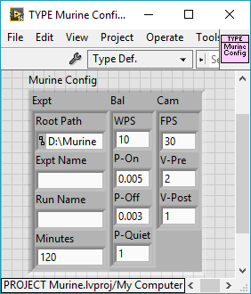

I use TypeDefs a lot, in particular for almost every Cluster I define.  Some of these Clusters have Default Values that I define as part of the TypeDef.  For example, here is a Configuration TypeDef that has three Clusters as sub-parts, for Experiment, Balance, and Camera, each with several parameters.

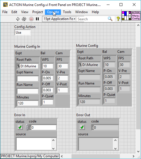

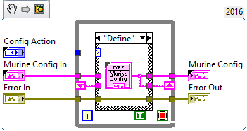

In my code, there are numerous times when I use this TypeDef as a Control, an Indicator, or a Constant.  For example, here is the Front Panel and Block Diagram of an Action Engine that lets me Define, Use, or Replace this Config (Define means "Set to the Constant defined by the TypeDef", Use means "use the Defined or Replaced Value", and "Replace" means "Use and remember the Input Value").
Note that the TypeDef Cluster is shown in "Iconized" form, really handy for self-documentation and taking up little space on the Block Diagram.
So here's the Unexpected Behavior (which may well have been there all along, it just didn't Byte me where I sit down).  I recently changed the TypeDef, specifically the values P-On and P-Off.  When I looked at the Control in this Action Engine's Front Panel, it showed the original value (which didn't surprise me).  However, I couldn't use either Quick Drop's Replace nor the Right-Click Replace command to put the new TypeDef (with new defined values) in its place.  Instead, I had to do the following:
  • Search for (and locate) the TypeDef Control or Indicator.
  • Delete it.
  • Using Quick Drop, insert it again using the name of the TypeDef.
  • Rename if necessary, change to Control/Indicator as needed.
  • Rewire in the Block Diagram.
  • Reconnect to Connector Pane.
But that wasn't all!  I was a tad careless -- my Search also turned up the TypeDef Constants (such as the one shown on the Block Diagram, above), which I didn't realize also needed to be replaced.
