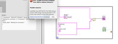

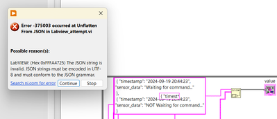

Unflatten From JSON
Although with this input I am able to have the correct output  :
 When  I try to write more to my JSON string i get this error  :
I have tried to change the timestamp and sensor_data types to arrays but it didn't work.
Lastly I would like to parse a JSON file which contains information just like this but i cannot make the function start unless I have a JSON string, which defeats the purpose of reading a JSON file altogether.
Kindly address both my problems.
Thank you in advance

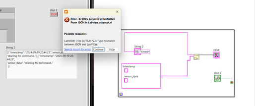

In this casetext has to be [{},{},{}], There are no square brackets in your string.
Message 6 of 9
(3,022 Views)
 when i dont have the brackets i get and invalid string form but when i have them i get a type missmatch
Message 7 of 9
(2,960 Views)

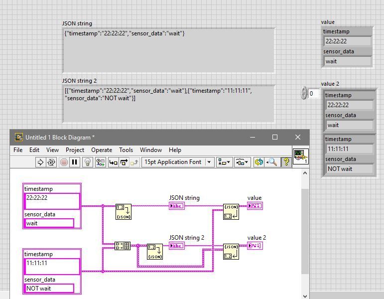

You need to wire an array of cluster for type
Message 8 of 9
(2,955 Views)
Now you format it as an array but asks it to unbundle a cluster ...
