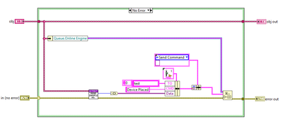

With clear inputs/outputs, UT is not an issue. However, I do not find a good and practical way to UT VIs that have internal LV communication processes (Queues, Notifier, Shared Variables etc..). Please see the example below.
Question: how would you Unit Test this VI?
History: LV is used inside a medical tester and we had some issues that some messages hasn’t been send to the good queues/wrong message that causes a crash months after shipping. I let you imagine the rest ...
Requirements: I need to make sure the good message has been sent to the good destination.

I was thinking to mock the messages with a class or to wrap the queues library to have an “debug” mode (I will suggest that to the dev team for future machines). However, these two solutions would be very hard to implement and requires to changes thousands of Vis for every previous medical testers. The easiest solution is to create an indicators for the message. But this method might fail as I do not test to which queue(s) the message is sent.
Hope it is clear since I have my head in that since months. Many thanks in advance for your help & suggestions 😉

I would ask myself this question - "what business logic do I need confidence in that could be subject to change?". Unit tests, after all, add the most value if they provide a safety net for unintended changes.
In your case, there is little benefit in testing the Queue API itself. It has been thoroughly tested by NI and thousands (millions?) of users. The real business logic here is (my interpretation of your VI):
1. A data packet is created, based on real-time ("sample data"?) and static (the hard-coded constants) state data.
2. The Queue API is called to enqueue this data packet.
My first reaction to test this is:
1. Create and instance of your class.
2. Obtain access to your internal queue
3. Pre-configure the "sample data"
4. Call the VI
5. Dequeue from the queue and check the packet

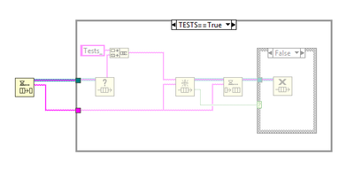

I've seen people using helper queues added to dequeuer for testing that kind of things. Assuming you are using named queues.
