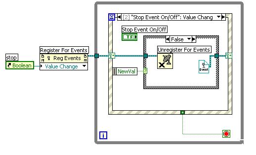

You can only unregister events dynamically that were created dynamically. So instead of statically creating your event for a front panel control, wire its reference into a Register Events VI and select the event you wish. Then you can dynamically unregister and reregister the event as needed. See here for more information, though keep in mind you'll be using control references most likely instead of user events.
Actually, this is a much better link to look at.
