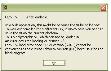

I'll stick to this thread.  I'm not sure why this error occurs, can anybody help?

It has got no block diagrams????:smileyindifferent:

I'm sorry I am not an experienced labview programmer.  I am merely trying to get my program re-written in labview 2009 since Windows 64-bit runs it properly as a 32-bit program.  If you can tell me what I need to look for I can carry out a search of the source files for this program.

LabVIEW 5.0 without a block diagram can be opened in LabVIEW 5.01 but not in LabVIEW 6.0. see here
Moral:
(Backup before removing diagrams.......)
