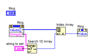

Hi SenSLabs,
I think something like this would do the trick:
Tom L.

Bill an Mark,
thanks for your suggestions!
They are not exactly what I need, because they change the possible ring entries, which I don't want. For example, if I start a run with a ring having possible strings as ("a","b","c"), then I want to select one of those on the fly (say, change to "b") but at the end of the run to still have the ring's possible strings as ("a","b","c"). Your solution would replace those with one value only ("b" in my example above).
I am going to try Tom L solution now.
Thanks a lot for taking the time to respond!

Hi Senslab,
to select one of the ring's entries you simply write it's associated value to a local of the ring (or use the value property...)!
When you have the strings "a", "b" and "c" (with values 1,2, 3 respective) and want to select "b" you have to write 2 into the value property!

Tom, this is great, thanks!
Message 8 of 11
(5,221 Views)
GerdW,
Thanks as well, it is indeed the case!
Message 9 of 11
(5,217 Views)
Glad to help!
One thing to note is that you'll probably want to add logic for strings that aren't found- the search array will return a "-1" for the array index and then the index will return a value of zero (the default value for the data type.)  A case structure with cases for -1 and 0, default with logic appropriate to your application (error reporting, etc.) would be a good start.
