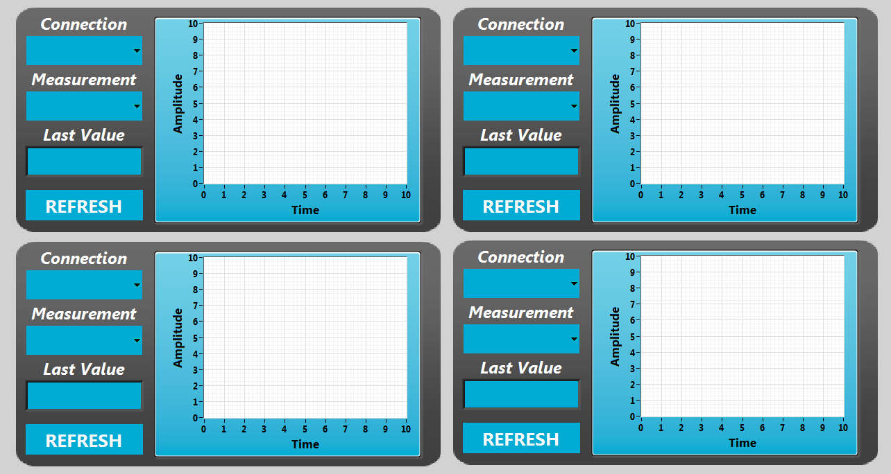

I have a panel of 4 (with possibly more to come) type-def controls that I would like to figure out how to reset to their default values when the program begins to run. With the hope being to keep things tidy, are there any other options when trying to reset the controls within these type-defs? Or do I literally have to create a Return to Default invoke node for each and every contorl?

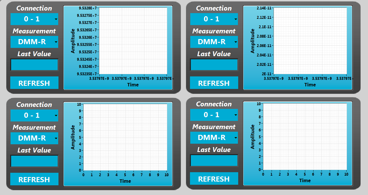

I know it's a silly request, but I have now created an array of references. When initializing to default, the previous axis values stay. Is there a way to reset these for appearance sake? I'd like the top two graphs to look like the bottom two when restarting the application.

Graph axes are not values of the control so they will not be affected by the Default Values method. You can set the axes by property nodes. It has been a while since I worked with those properties.. Some properties behave differently if Autoscaling is on or off and there may be other interactions between various properties.
