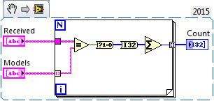

@crossrulz wrote:
As far as couting the different models, Variant Attributes work extremely well.
In my experience, variants are overkill. A simple sum of an array of 0s and 1s does the trick much faster.
Cheers
