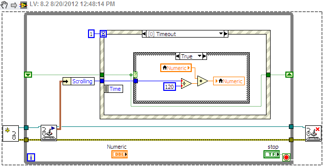

You could cheat a bit...  There are two hidden cases that set the boolean in the Shift Register True or False when the Numeric Mouse Enter and Mouse Leave events occur.

Jcarmody, thank you for the screen shot.  I like this one.  Can you also show the hidden event cases or attach the vi?

Another option would be to change the timeout.  This would avoid the timeout event every ms when the mouse has not "entered" the contol.

Crossrulz, thank you for the vi.  Can you save it as 2010?
Message 8 of 21
(5,726 Views)
I gotta start remembering to save for previous when I post...
Saved in 2009.
