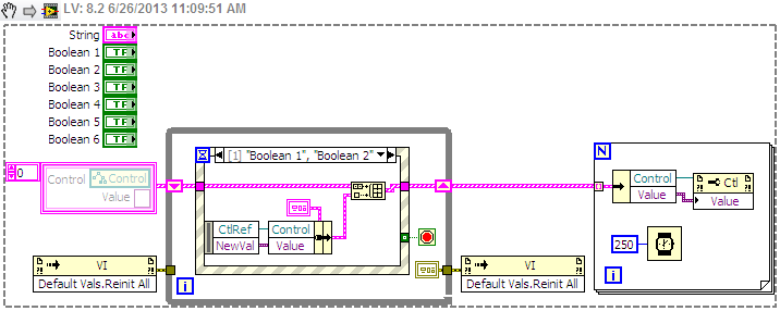

Here's something that records the sequence of Booleans and one String.  Run it, hit any sequence of buttons, change the text in the String control, then hit Stop.  The buttons and String control will replay the changes in the sequence you entered.  You can add a timestamp to the cluster and replay with the same timing, too.  This is just a quick demo; you can do a lot more.  The key is in the event structure, just add to the events that the visible frame handles to add more controls to record.
