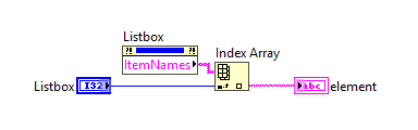

I cannot open the VI because I have LV 2016, but this is how I would display the text from the listbox:

How do you want the data to be displayed?  Do you want the index or the string value?  If you are after a string value, I recommend you look at the Combobox.  A Combobox looks like a drop down menu item and has a string data type.  This makes the code simpler for you.
