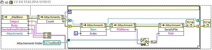

Hi All
How to read attachment file from outlook using activeX?
Luong

Please start a new thread if you have any more questions and place a link to this thread. Please dont hijack someone else's thread.
