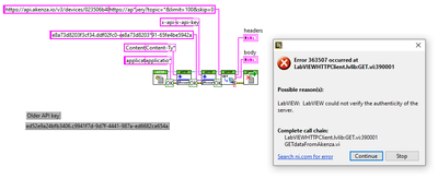

I am acquiring data using the BOSCH XDK110 sensor and sending the collected data over MQTT to an IoT platform (https://akenza.io/). I want to now display the data onto LabVIEW from (https://akenza.io/).
I am using HTTP GET method but unsure how to use the API with the header to display the data.
I cant find any examples that use HTTP GET with an API. The examples are directed for HTTP GET basics.  - I have tried the basic examples to display data to LabVIEW by connecting to platforms that require no further inputs other than a URL.
Has anyone managed to achieve something similar?
- Open to suggestions on how to retrieve the data (if there are other easier methods)
- Hoping for any example .vi's
Any advice towards achieving this is much appreciated

Thank you for tour response.
Unfortunately, this does not work either. I have tried this with a newly generated API
(5,802 Views)
Ah, sorry, I should have paid more attentions to your error message, I just got an "unauthorized" message.
Have you seen this KB article: Error 363507 When Using the HTTP Client API in LabVIEW? I see that you are on LabVIEW 2015. Your certificates are probably outdated. You can either disable server verification, add the certificate to your ca store or update the ca store. This post has more details: https://lavag.org/topic/16601-labview-could-not-verify-the-authenticity-of-the-server/?do=findCommen...

Yes I am using 2015. I have worked around this by using a newer version from a different PC but would like to get this resolved on the 2015 version.
- I tried to disable verification. This does not work either.
- what I would ideally like to do is 'update the ca store' as mentioned, however following the steps I have found I am not able to complete this. The links attached are what I tried to use:

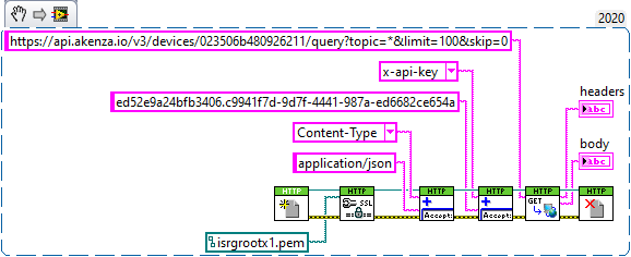

Accepted by topic author jephin27
That does not apply in this case, since you are not connecting to a server for which you have a private key.
Since api.akenza.io uses a Let's Encrypt certificate, you should be able to download the ISRG Root X1 certificate from https://letsencrypt.org/certificates/ and point ConfigSSL.vi to that CA certificate file. You can also append the contents of that file to your ca-bundle.crt.
Edit: You may also want to look at this site on how to get an update version of the ca bundle: https://curl.se/docs/caextract.html
