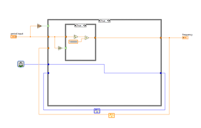

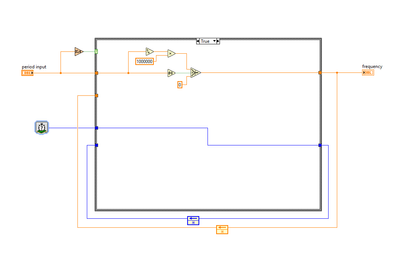

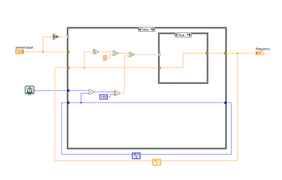

Here's the code. This gets called from another vi which runs in an infinite loop in sync with the scan engine and feeds the period measurement from an ni 9411 into it.

Hi aharres,
@aharres wrote:
Here's the code.
There's no code. That's just images of code!
Would you also post images of Matlab code or would you post the m/txt file?
Btw. the inner case structures can be replaced by select nodes.
And the reciprocal/multiply combinations are just glorified divide operations!
