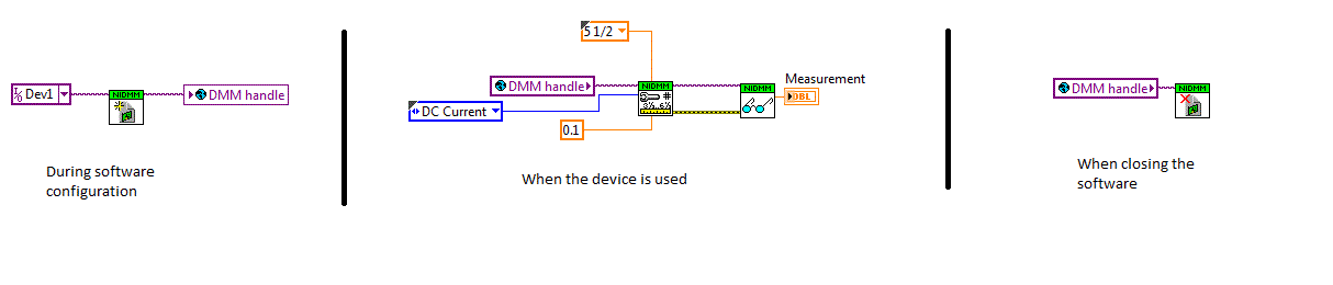

I am wondering if it is a good or bad practice (or perhaps doesn't matter) to keep the handle of an open device as a global variable. See image below for example:

I find it better to use an Action Engine to control your devices.  That way the reference stays local to the VI.
These days I actually prefer to use a LVOOP object. You can create a singleton object so no wires need to be passed. The benefit of using this method is taht you can create various methods (what would have been actions selected with the ENUM in the action engine) but you have the freedom of having different connector panes. Much more flexible.

Here's a reference for the Singleton Pattern in case you want to go that route.  https://decibel.ni.com/content/docs/DOC-13462

No, the comments go to "your approach may work, but using alternatives might reduce errors..."
"may work"... What problems I might face?

"Race Conditions" are a big topic, whenever you don't obey the DATAFLOW...

@Enrique wrote:
People randomly closing your task and not updating the task...
Multiple people trying to muck with the device at the same time (race condition)...
Please, learn from our experience.  Do not go the route of using a global to hold your task.  You will be much better off if you contain your drivers using an Action Engine or a Singleton.

OK, race conditions, I am well aware of that.
"People closing things"... yes can happen. (I found this funny, imagining people inside your code Smiley Tongue)
I think I had the insight. Thanks for your responses!
