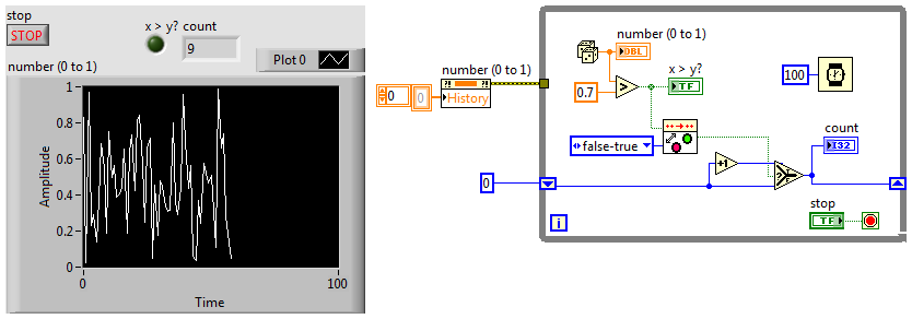

would this work?

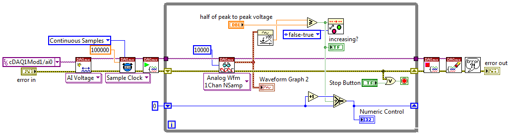

Wow, I can't believe I didn't notice this was the same question I responded to a day or two back.  Getting old... Smiley Sad

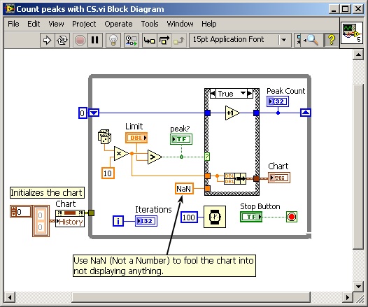

I made this little VI to show you the simple way and it's pretty much the same as Apok's solution but he added the DAQ code and mine has some nice bells & whistles in case you want to get fancy.
ahhh...well no.If your value is above your set point and dwells more than the loop iteration, your case statement will add those count. Bool crossing eliminates that and counts only at the crossing and not during the dwell period above the set point.
edit: and i failed to recognize your bells and whistle  Smiley Very Happy
