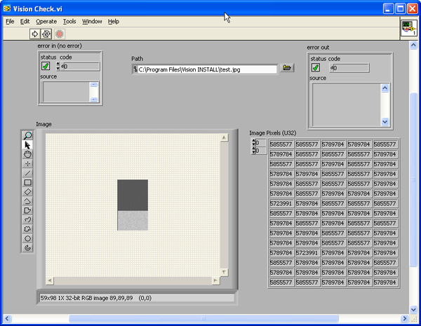

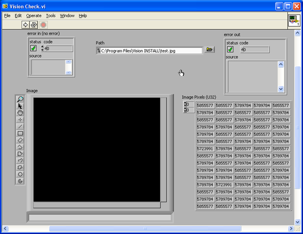

I created a sample VI with the same problem.  All functions are standard.  LV projects are included to create an EXE and Install the program.  I manually loaded the two vision dlls.  I've included screen grabs from the development and target PCs to show the display behavior problem.  Any help is greatly appreciated...

I already point above that you have missing PlugIn folder in Run-Time folder - this is the reason. These files not included into standard LabVIEW Run-Time. They will be deployed with Vision RTE or IMAQ. If you want to avoid both in your installer, then you have to include these files into your own installer manually.

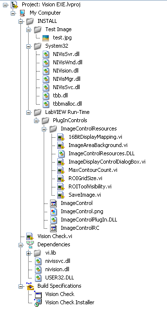

First you have to put all support files in your project. I will create INSTALL virtual folder where I will put links to all files which are necessary:
In system32: NIVision.dll and other Vision DLLs. Take a note, that I have Vision 2009 on my PC, so there are five files. If you have older version, then you may have less files (I don't remember which files was added in latest version) - see what you have in your System32 folder. Also take a note that I have included tbb and tbbmalloc (Intel threading libraries) required for Vision. They may be not necessary for older Vision versions.
Also I have included into project "missing"  files from LabVIEW Run-Time. They are present on your development PC.
So, the project looks like this:
20021i74A49B302EDCB41C
For better understanding - file view:
20023i4FFB887EDA1192A3

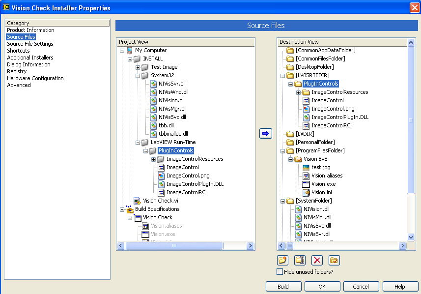

Well, now go to installer. I just should put files into according folders on the target machine:
20025iD8060B5B08D78965
Attached changed project (because it contained fixed paths, some changes may required)
Hope it helps,
Andrey.
