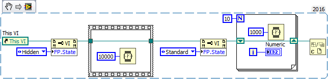

You can hide FP by property node
Also, if you want to hide the taskbar icon you can edit the INI file of your EXE.
Include the key "HideRootwindow=True"…
I checked it in LV16, don't know about 11.
