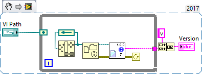

I include a build version number in the "About" Window. See below:Snap1.jpg
The code is as follows:
The above works for the EXE version(run-time system), make a case structure when you are running in the IDE version to say something different like IDE  Version.
