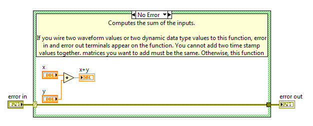

-The principle is to include all the documentation you want to add to your VI into the subdiagram label of the error case structure of your subVI.
-Connect all the inputs/outputs to your terminal.

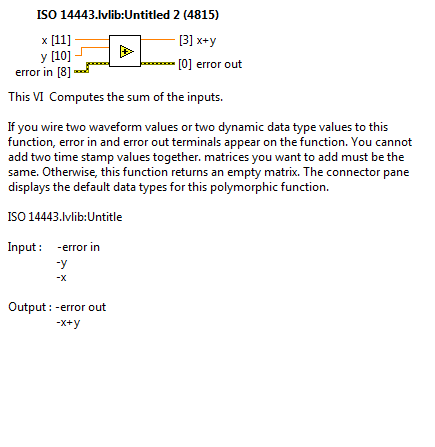

-Then use the quick drop shortcut “ctrl+space then crtl+c”

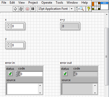

- Your VI is documented with your comment and the names of your inputs and outputs.
